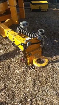

20171004_164230.webp This is a picture of my chipper tongue with flat front plate, six hole adjustable, which I could add a 'stinger' to to lengthen tongue for different truck set up. Top two holes are occupied by shackles for convienience at this time.

View attachment 47380 This is a picture of my chipper tongue with flat front plate, six hole adjustable, which I could add a 'stinger' to to lengthen tongue for different truck set up. Top two holes are occupied by shackles for convienience at this time.

Merle no problem. That is the same set up as my 1390 with the 6 holes. I do like your idea with the clevis though it should save the latches on the hooks as guys usually just Hook them to the plate and bend the latch. I will be adding the 2 5/16" ball coupler in the next week or so cause I hate that pintle. Just got to paint the hitch and install.

I have a pintle ring on my chipper, too, similarly mounted.
The pintle ring/ hook will definitely contribute slop to moving the chipper with the loader on uneven ground.
I had not considered swapping to a ball and ball-coupler to eliminate slop, until this point. I might.
