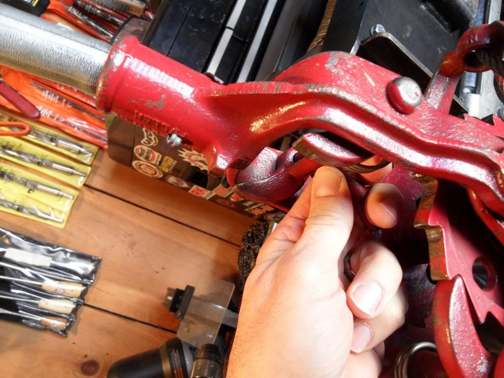

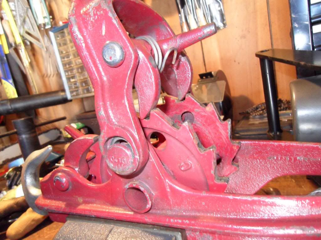

If you look closely, you can see where/how the spring engages the pawl on the left. It has a hook that grips the pawl lever, holding it toward the spool. The spring for the pawl on the left is not engaged on its lever. Let out enough cable to allow the lever to flip back over, and re-engage the spring. I was thinking....a loop of cable may have grabbed the hook on the spring, flipping it off the lever.

i appreciate the responses..i took all the cable off and took a really good look at what was going on and this thing is pretty beat. couldnt get it to flip back right away. ended up getting some pry bars and the help of a hammer and i got it to flip back. i think i can get it to work as long as i dont pull on it at the optimal leverage point (when the handle is perpendicular) because at this point the play in the pivot cause the teeth to be misaligned and it will just fold next time i yank it. funny thing is when i have the handle engaged with just one click left of room the teeth seem to be aligned correctly. so if i use one click at a time i think it should work.
i will post some pics later today to show the wear.

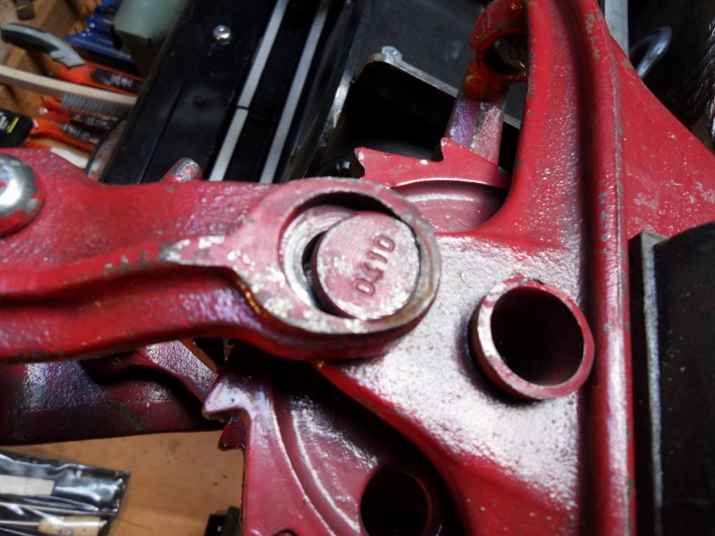

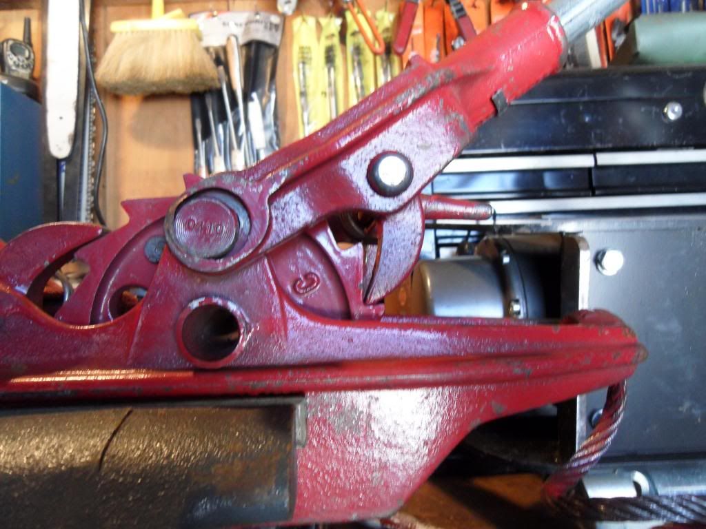

wear at pivot
I just went and looked at mine. Neither of them have the holes wallowed out like the ones pictured above.

I did look at that....the angle on mine is more favorable than yours appears to be, somewhat like yours in the last photo. The pivot points are not near as elliptical as yours. I can't tell if yours is that way from wear or from casting flaw. I've had my oldest one for probably 12 years, maybe a bit more. I bought the other one in 2011 I think. It's only been used once or twice, but the older one has been used countless times.

Looks like a faulty unit to me. Even if it were stressed, the holes in question would not be affected, as they are merely the pivots for the handle.
I agree, it does not look like it was stressed. It looks like the metal has just worn from use like it was not durable enough for the task.
The wear is where it would be expected to wear from cranking the handle though. Every time the handle is operated where it is worn is exactly where the force is applied.
Agreed, but judging by the remaining paint, and the fact that he said he bought it new last spring, wear seems out of the question. Mine looks way rougher than that, and yet shows far less signs of wear.
