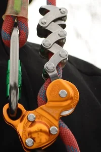

The "sit back" on the zigzag is less than 1/2 inch or 2cm or so. Very minimal and far less that with all but the highest best tuned friction hitch, slack tender combo. I can't speak to the uni as my exposure has been limited. I believe the zigzag is lighter. But I have yet to do an actual comparison.
Here are some pics:
Very compact
No problem at about 30ºf or 0ºc
A compact "M" set up
Last one
That is one pretty tool! So does the ZZ not fully collapse when going up?

Usually, but depends a bit on line diameter, climbing style etc. With enough rope weight straight beneath it the slack falls through.
AustrianMax,
The line is actually 7/16" or real close to 11mm Kernmaster. The devise is rated for 11mm to 13mm . Everything up to 13mm seems to work well.

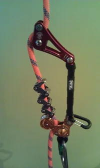

Here is a pic of my ZZ/RW/7" stiff tether combo. The tether is made of stitched New England Tech cord and shrink tubing. So far so good, but I have only been on it a week.
Donny
The rope in the pics is Kernmaster, but I also use poison Ivy with success.
Just as with cordage there are differences, but in my experiencve they have been minimal with ZigZag performance.
