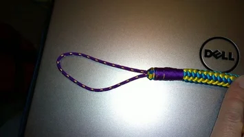

I have been thinking of doing this on my bigfoot line to feed it through my zigzag easier. I was thinking of tapering the line out over about three or four inches. Then add in a 3mm line loop as was shown above. But instead of heat shrink I was thinking of whipping the end with a line mean for just that. I have whipped a bunch of lines before that we use for camping and canoeing and can make it tight enough to hold the 3 mm lop in place. Just wondering if anyone has tried this? Or any other method other than the ones mentioned above? More pictures would be great.
Well here is my first attempt. I didn't hqave my zigzag with me when I did it, so when I get home I will see how it works with the zigzag. I tapered the core and then added the 3mm cord with the thread up through the core and finished it off by whipping the end.Loop 001.webp
