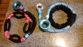

Here's a couple ring slings I made a while ago. I really like the single ring ultrasling. I also decided to splice the double ended ring sling in double braid because it's much easier and secure in my opinion. I went with 20 mm serius bull rope solely for the color scheme...gotta keep it fresh.View attachment 43161
I like that style of ultra, so is the ring splice a straight bury there?
I think the Sirius line series are nice to splice and make nice slings.
I thought it spliced quite nicely. The mbs is lower than stablebraid or dynasorb but not by much. I don't have much experience with the Sirius ropes but they seem to be nice cordage.
The sirius lines are super tough and abrasion resistant. I am definitely a fan after having used the 14mm line heavily for the better part of a year.
I always wondered if the lower strength numbers were because teufelberger uses a different measurement standard than most american rope manufacturers. That or its the 32strand plait.
