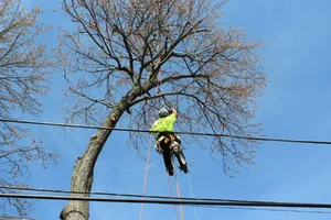

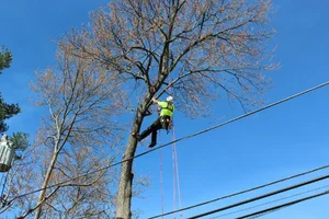

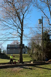

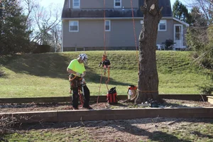

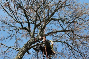

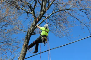

Used my Wraptor on its first job today. Really nice to ride up and conserve energy. The customer took some pics so after he emails me them I will post them up. I did add 2 rings to my bridge last week to facilitate swapping over when if I can't stand on a limb. Used that method today and worked well. Basically just a ZZ climbing line on Wraptor, second ZZ on a 30 footer. Ride up to desired height, install short line ZZ on R or Left ring. Descend Wraptor ZZ to engage short line, precend with getting off Wraptor and installing climbing line. A little gear intensive but without a limb to stand on it makes the swap less painful. I hate the D-Ring squeeze when hanging from them. Really with the Wraptor I'm not sure that there is ever to much gear. Heck at my weight I'm good for at least 100lbs of stuff before I hit the weight limit of the Wraptor.
