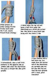

Here is a selection of modern hitches and how they relate to one form. Moving to chords as tails for the friction hitch and these closed french coil hitches is kinda high performance, slow walking tuning stuff of patience and extra care.

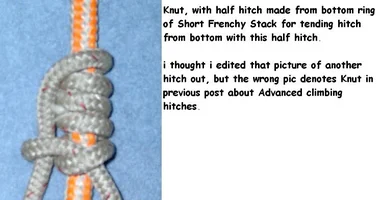

i posted the Knut pic wrong, in all my editing! The directions where write, but the picture was of something else i was werking on and didn't jive!
Sorry!
-KC

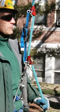

Does anyone have any pics of their srt ascent set up? Any advice on ways to tie off w/ out the use of a gri-gri? Right now I have a petzl handled ascender up top, connected to my belt w/ a length of lanyard, pantin at the foot and am debating on what to use at the waste? Any suggestions? Is this a good set up?

I use my VT hitch below my handled ascender when ascending SRT. I feel it is a lot safer than having the hitch up above the ascender out of my reach. The only way my VT could fail is to push down on it. If I quit pushing down on the hitch, it grabs. If I touch the side of the hitch, it grabs. The only way I could force my hitch to fail would be to force the ascender open and useless, then pull it down on top of my hitch and keep pulling until I hit the ground. If I were to do ANYTHING other than pull down on the top of the hitch, it will grab.
A hitch up above the handled ascender is about useless since it will be the first thing to get a twig jammed in it. It will also be out of reach most of the time so I would be unable to dress it.
With my hitch at my belt and my handled ascender on a 30" strap; above that, my ascents are quick and safe. Once at the top I can remove one ascender and clip in the standing end of my lifeline and go straight to work. My hitch is already tied and I don't have tons of gear to deal with. One handled ascender and one 30" strap.
