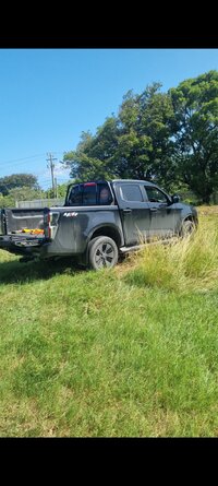

A ranger man. Nice truck, I am an isuzu dmax man.Screenshot_20250212_211546_Gallery.jpg
