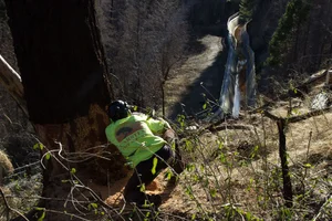

This is from a job we did a couple years ago. Good size dead Douglas fir leaning hard over a water flume. I apologize if I’ve already posted this here, my weekend job is snowed out and I’m bored.

Somehow got my pics out of order, but I installed a 3/4” rope about 40’-50’ and ran it up the hill to a block on another tree and down to a porta wrap to compensate for the side lean then jacked and wedged tree into the lay. After it was on course and committed the groundie let go of the rope and it landed perfectly on the hill above the flume and locked in above a stump.

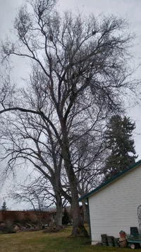

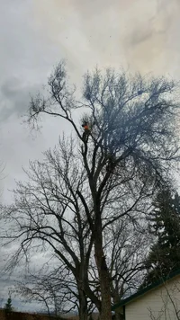

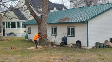

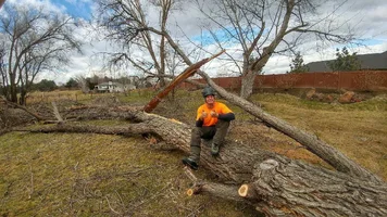

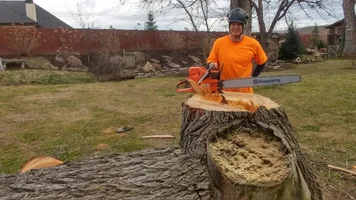

Siberian elm from a couple weeks back. Short climb to get a little weight off of the garage side and a little reach off of the opposite side to miss neighboring trees on its way down.

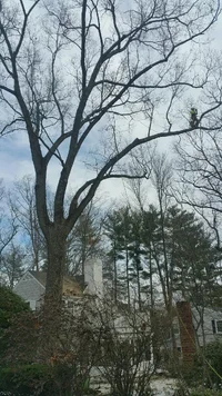

Dead wood and some building clearence on this oak included the removal of a 12 - 14 inch horizontal lead over the chimney and deck. Lots of cutting smaller sensible pieces all double roped and tag lined away from structure. You can see all of the saw dust on the roof.
