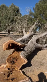

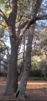

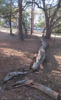

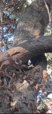

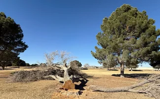

This poor oak had a tough life and then died. It started out too close to its neighbor, and the trunk constantly rubbed on the limb. Near the end the trunk had split open and fallen over so all the foliage was lying on the canopy below.

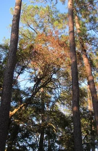

Fortunately, it was surrounded by high pines that leaned toward the work area. They provided nice TIPs for my climbing and positioning lines, and I was able to move around to cut it up from above and drop pieces with no damage to the canopy below.

That left the trunk which broke apart when felled. I'm glad I had decided beforehand that it wasn't something I wanted to tie off to. That rubbing wound on the trunk never got a chance to heal.
This was a new way of working for me and it worked out nicely. I was worn out and happy after making three climbs in one day.

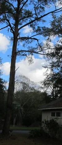

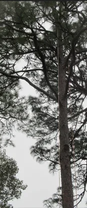

While climbing this pine to remove several smallish dead limbs I noticed the old damage on the upper side of a live limb. It was already starting to sag there so I made a second climb with a rigging rope. I set it up so the outer part would rest on a lower limb while I cut off as much as I could on the inner end. It was balanced nicely so I lowered the rigging rope to the ground so I could tip the limb to fall clear of the shed.
Same yard with the long walk to the debris pile, so I got a lot of exercise.

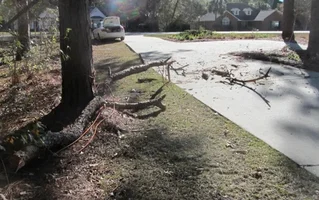

Largish dead limb over the driveway was six inches in diameter at the cut. Rigged it with a speed line. Lots of noise when it hit the concrete, flipped partway over, and stopped with the big end up in the air. I untied the speed line and eased it down from there. Big job for the ugly little Kobalt saw, but it just keeps on cutting.
