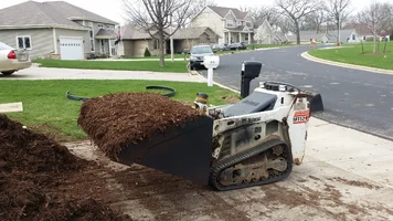

See that is why I own the bobcat brand.. with the mini bobtach I can pickup and run any fullsize attachment 20160422_145207.webp
See that is why I own the bobcat brand.. with the mini bobtach I can pickup and run any fullsize attachment View attachment 42561
I never knew the mt52 could use a standard skid steer bucket. There are no bobcat dealers conveniently located to me which is why I choose any other mini I got a good deal on. I like having the ability to rent attachments nearby for it for the rare odd job around the house.
