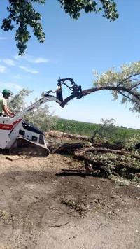

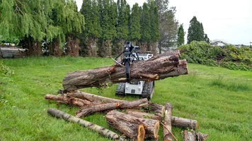

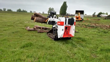

Well I have put over 130 hrs on the mt85 now. I am really liking it. Reverse speed seems faster than what they listed in the specs.tmp_30092-IMG_20160629_1150519261279987356.webp tmp_30092-IMG_20160520_152950494_HDR-1665674493.webp tmp_30092-IMG_20160520_153008333_HDR-480354490.webp
