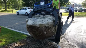

Did you get a grapple for that bad boy? That thing must be a digging beast with that bucket! The only time I really notice lack of power with my 25hp jobber is when using the bucket to dig and plow with. I rented a 40hp? ditch witch for a few months last year and boy was that turbo spooling when loading er up with dirt.
