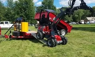

Your absolutely right Dave ,I don’t know why more guys aren’t using them they are clearly missing out! I ended up getting an avant 528, but the giants a great machine also, and I owned a mini skid for 6 years before buying the Avant. Not having to put mats down is a huge huge plus. Mini skids are lawn wreckers no matter how you look at it ( well nice lawns anyways) I still have my mini skid for a second crew but it’s night and day having the avant !
Dave, we sold our tracked mini after we bought our Giant from you. Articulation is a Giant step up. The pun was not initially intended :). It is a very well built and incredibly reliable machine. 2.5 years and ~1800 hours and it just keeps on going. Going back to tracks for me would be like going back to dial up internet.

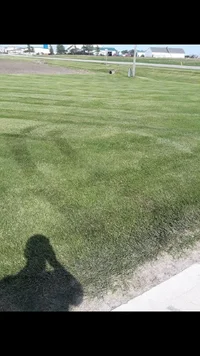

Personally I do not put down mats and have only had issues on muddy slopes with my miniskid. Here's an image of a 180° turn that I did at the dealer when I bought it. Plus being a mini I can load it in the chip box (this is huge for me as I often work alone, so I can still get all of the equipment to the job in one trip) and I can still turn in place if needed.
I would certainly be happy using an articulating loader, but needing a second trip just to get the equipment to the job is a deal breaker for me. I'm sure it works great for you guys running a crew with enough drivers to bring all of the equipment.
