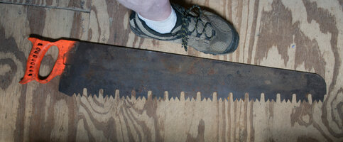

Okay fellows, I dug around in my garage and found my hand saw from 1968 that I used everyday, all day cutting elm branches 8" or smaller.
Foot in the photo for comparison.
And yes, that is a steel handle. Try toting that on your harness. Weighs more than an Echo CS2511T. It use to have a leather scabbard that hooked on my belt, but I eventually sawed through it enough putting it in and taking it out that it wouldn't hold the saw any longer. The scabbard alone weighed in at about three pounds. Needless to say, I was one happy kid when I saved enough to buy myself a used Mcculloch 440 chainsaw, which weighed a lot more but made my life so much better, when it actually ran.
