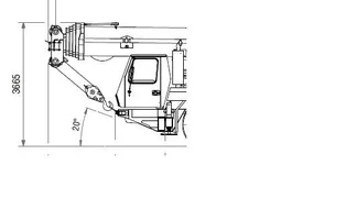

I know the techniques for tying in to an american-style crane (the wire with the big ball at the end), but how do you tie in to a "european style" crane? Like for instance a Grove GMK3055 (55 tons)?
I normally always climb the tree because there is no rules for being lifted in the crane in Denmark, so the crane companies won't do it.
That is just a block for parting the line, you can still tie into those above the ball or through the hook, so long as you use a masterlink and the hook has a closed and locked gate.
The 3055 comes with the hook you showed and the traditional single part round ball. we use both frequently
