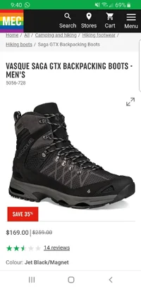

For fellow Canadians in the market....found these at MEC. Needed a new pair of climbing boots so due to the price decided to give these a try. Have never owned any Vasque hikers before, but for 169 I thought worst case they become everyday hikers...15-20 climbs on them now and I must say they are pretty damn good. Nice rigid sole, good ankle support, much narrower then my chainsaw boots and the vibram sole gives good traction. The poor reviews on the site all seem to be due to the laces breaking...5 bucks and problem solved. If your in the market these are a good lower price alternativeScreenshot_20190617-094052_Chrome.webp

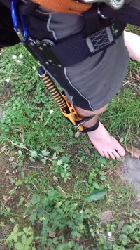

All jokes aside, I agree with @SomethingWitty, relatively cheap hiking boots are the best. I wouldn't want to destroy a couple hundred dollars worth of shoes in a tree all the time. Then again, I don't do this for a living.

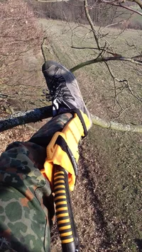

What I use are hiking boots by Mountain Guide, I found them for 15€ at a garage sale, they were worn only once. They are the most comfortable shoes I have ever worn I use them at work, for hiking and of course for climbing. They have good grip and a relatively flexible sole, but not so flexible that you can't stand in a tight crotch or use a 6mm footloop for an extended period of time. I don't know how they'll be with a foot ascender, I don't have one yet. I've had them for around a year, they are still going strong, and I don't go easy on them.20190217_162413.webp
