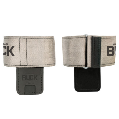

klein hydra cools or big buck wraps? Or is there something else better?
Big Bucks are not my favorites as they are just to bulky and hot for me. I really like the Buck Cushion Wraps with the inserts though. Make sure and get them with the inserts that fit the BuckAlloys.
