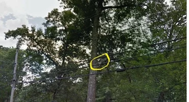

What Do You Guys Think of This Climbing Job?
To your question of if safe to climb, are you asking if we think your bodyweight and shaking around, plus the force of the limb coming off, might break the tree? Throw a line over the limb, and bounce-test it.

What's the circle circling?
The circle is representing the limb hes being asked to remove..
What say you, Monkey? You take the job? Already do it?
I can't tell how close those utility lines are but, if your going for a high tip just out of habit, just be cautious setting/retrieving your throw line, ropes, etc.. Maybe you can get away with a lower one on this one & not even have to have your cordage up at the same level of those power lines. Just get to that circled location & advance yourself up a little more with a spar cinch or something.. you kno.. whatever gets you to a good work position to splash the thing..
I decided to opt out of that tree. Still gonna do some other work on the job. Probably gonna look at educating myself some more on working near wires.
Technically not just anyone is supposed to do work within a certain distance of power lines like that right? Only qualified individuals with the appropriate training?
One of my thoughts exactly was shooting the throw line up there and if I miss what if it bounces off the tree and then goes over the lines or something. Just one possible hazard among others.

Not just work within a distance, but work on any tree within a certain distance from the line. The distance varies by the size of the line. When in doubt, stay away.
I got zapped once. It sucks. Now I have the power companies give me clearance every time before I jump in a tree that's all up on the lines.
Nothing wrong with walking if your not comfortable, just for future info if your not aware, there are 4 wires that look bare in your photo. 3 will be power and one should be a tension line to help the poles hold the weight. The lower ones near the limb in question are all data wires for phone and internet.
Data wires still require caution when working next to them so as to not damage them and receive a large bill, but the electrical risk is greatly reduced (technically data lines are still electric, but I am not sure what kind of voltage they can actually carry)

I know old analog phone circuits are -48 volts DC & the "ring" signal is -96 VDC (or close to that). So, it's enough that you'd rather not cut into it but it probably won't kill you. I will make you jump & twitch so that won't be fun. Of course, if the twitch happens with saw in hand -- that could be a bad cut & now there's a possibility of death again.
