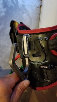

I heard tales of that leather/rubber material ripping. Especially from the weight of the chainsaw on a carabiner. I just got my first TM, it was the Evo, and went with the shembiner for a saw holder. Right away I didn't like how it pulled on that leather material but I like the shembiner so much I decided I could easily reinforce it with some 3mm cord. The shembiner has a couple tiny holes in it's spine that I was able to conveniently utilize along with the tiny holes in the harness itself. Now I'm confident I can hang a large saw with no problem.

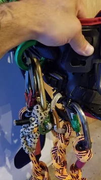

Only other thing I did maybe worth mentioning is the tiny tube loops I made on the left side to store my lanyard carabiners. I cut the tube at 45 degrees to make little squares because the tube would kink making loops that small. I use these to store a crab the captures the daisy chain loop and the other is for the terminal end of the lanyard. Keeps em close, but separate.20190526_200741.webp20190526_200759.webp20190526_200845.webp20190526_200658.webp

I was kinda of eyeing the possibility of my overhand knots coming undone or pulling through the holes on the harness. The way I wrapped the cord though, the tension from the weight of a saw shouldn't make it to the knots. I did carefully melt the ends of the knots as well to help from them working loose but I'm gonna keep a close eye on them. The biner is still supported by the leather so even if the cord comes totally loose, the shembiner is still secured by the leather material. Your gear loops loosening is a different story. Those come loose and you're minus some of your gear. If I have to redo the cord I will likely add a small washer behind the knots to help from pulling through the harness holes.
Only other thing I did maybe worth mentioning is the tiny tube loops I made on the left side to store my lanyard carabiners. I cut the tube at 45 degrees to make little squares because the tube would kink making loops that small. I use these to store a crab the captures the daisy chain loop and the other is for the terminal end of the lanyard. Keeps em close, but separate.View attachment 59955View attachment 59956View attachment 59957View attachment 59958
Eeeeek, see you made mistake I made. Your only on the leather. The strap / webbing behind the leather. That’s what I hook too. I use the shembiner on my left side, so if I’m in awkward position it makes for each stow of saw. But on right side, I use rock exotica transporter so that way when I walk around tree my sAw is locked safety. Use that webbing behind the leather.
I thought about putting the biner on the webbing but that would make another potential wear point that would be difficult to inspect. I'm happy with the way it straps up to the rubber.
Don't run a shembiner behind it. Maybe the bolt on hooks, but the shembiner has square edges that will eat at your webbing as it pivots slightly.
That is not a replaceable wear item, and once it gets chewed up, the saddle is done.
So your saying only put on the leather? Not on the strap? Cause everything I have put on my leather has fucked my leather up
The tire rubber stuff isn't life support. The shembiner barely fits in the caritool spot and moves very little, but it would eat your webbing.
My rubber stuff is not chewed up, and I'm rocking the grey shembiners for the third(?) year.
