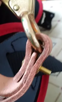

I added a brass snap for my Silky saw, a DMM roller 'biner for my running end and I'm trying out a double attachment pulley on the bridge. The pulley worked brilliantly during descent yesterday with a rope snap and Fig 8.
A carabiner for the running end is something I use during ascent only, usually. But coming down if I take a different route and the rope gets re-directed then it really proves convenient, keeping it taut beneath my friction hitch instead of pulling upward 180* right at my hitch climber pulley. That's a PIA situation if you don't have a fix for it.
The brass screw protruding past the threads on the rope snap is sharp as hell. I used part of a plastic cover for a 3-way plug from a new power strip. One flat plastic piece is a nice tight fit to keep that screw from trashing this new harness. I'll saw or grind it off eventually...
