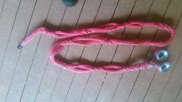

That one I made is all locking brummels and one piece of tenex. Haven't tried the boomsling instructions but it looks interesting.
If I were to do it again I would use two pieces of cordage.
My idea was to have it terminate with a pocket as opposed to a tail so the full length would be usable. Start with a pocket at the tail, working my way up to the rings, leaving some room between the last pocket and the rings so the last pocket would be functional, then breaking down the braid to perform the locking brummels. It's the only way it seems possible to my simple mind.
