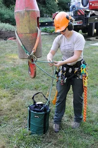

close up of the Tidano ball......kinda like a torpedo
what do you all think of this tie in?
Nice setup. With that tie in point it should make both parties happy, as the tie in point is in the middle.
Is it possible to fabricate something to the ball so you can install your your friction saver there, something low profile?
That way you will not be on the load line or the hook.

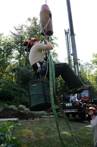

Figure I will throw some more gas on this fire. I’ve tried this before and not had the time to go into detail but here it is. The big problem is there is no way to standardize due to the wide range of configurations out there. Most people rent a crane and use what shows up. I’ll make this short here are a few pics. I use a 60 or 85 ton Liebherr with a European ball. I like this setup because the becket and all connectors protected by the ball. I think if you are using an American style ball the best thing to do is to drop the ball and insert a connector with a master link and put the ball back on. No it dose not take a long time to do this.
