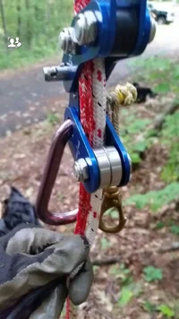

I finally had a chance to modify my RR. The 6001-2RS 12x28x8 bearings were going to require resizing the RR pulley axle so I used the 99R8 R-Series Radial Bearings which fit right onto the axle. A couple of 1/2" ID bearing shims I found at my local True Value are between the bearings and the side plates. Current set up is using the baby bump fiction plate. It runs great with out any hoking of the two lines. Certainly an improvement over the HH set up I was using before.
The ropes are 8mm Marlow Doublebraid. I was having trouble sourcing Sirius 500 and this seem to be a similar spec.
I am looking forward to working with this a lot more.

Just wanted to write quick here and say I tried the Twin Bearing mod. I'm not a huge fan since the sheave can allow each rope to run independently. When I set up a dual anchored configuration, I could keep the carabiner connection located where I wanted. It just drifted to center. Other than that, it feels pretty good. The solid flat sheave is the way to fly IMHO.

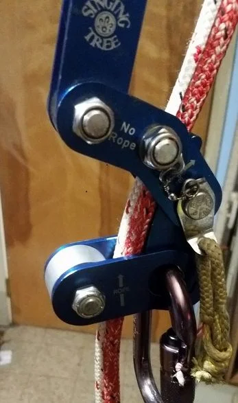

Well it took three attempts but I finally made myself a solid flat sheave.
This was cut from a piece of 1 1/4" round stock aluminum and the center drilled out to 5/8" to accept the bronze bushing from the original pulley.
If the weather clears tomorrow I will give it a try.
That's what you want, right there. I hope it works out. I recall the bronze bushing press fit into the aluminum isn't too tight. I've actually had a sheave drift to one side on my OG Blue RR. Unfortunately, I don't have the technology to drill that precisely on Center. If it's off a bit, you'll feel it on descent. My welded versions feel off until I finish hand filing them.
