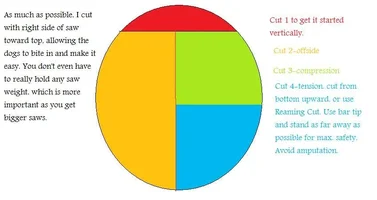

This is how the USFS teaches how to "Walk Down" a hung up tree. It should work the same for a partially uprooted tree. Its a pretty effective, safe, and ergonomic approach. The farther up the tree you reach, the more drop you will get, however you need to work in a little less ergonomic way, and the tree has an increased chance, though seemingly little chance of dropping on your foot. By cutting this way, you only need to get close enough to have the bar tip at the halfway point across the tree, if you have stopped cutting with Cut 2-offside at the half way point. If you wanted to cut Cut 2 further, you may, in some situations, need to use a wedge to keep it open. This would allow you to stand a few inches further back.

No Norm, I haven't done it in significantly larger wood. maybe some in the 24" range, but its been about 5 years. Can't say what the largest was.
When I was running a fuel reduction crew in Lake Tahoe, I had to "walk down" trees if my crew members missed their felling lane and hung it up. Mostly, the more qualified feller took on the larger ones, so they were less likely to hang them. It works really well, IME.
We thought about putting a clothing hanger in the one guy's tent, as a joke. He got called the Hangman a few times.
Why do you ask about the >24" trees? Do you think that the mechanics would be significantly different?
