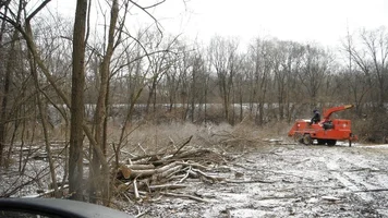

trees as backfill
I don't cut or split it I sell it exactly how it come off the job undesirable stuff included this was my point in why burry it is you can sell it and not have to process it
my point was...you can't sell schit wood around here...and looong ago I stated I was going with the consensus. Time to move on, nothing happening here lol.
