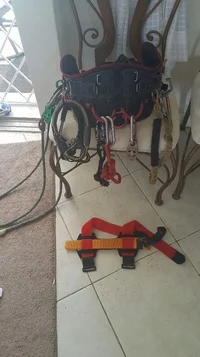

At that shembiner ...just a convienient place...my TM fits like a glove cause I have an ass....never slides down and never comes out of adjustment....2016-08-06 07.41.17.webp

Tim the shembiner is the bomb....easy one hand on and off the saw never comes off while ckimbing ....ever...it is a master idea...Shem ran it past me when designing the thing...never liked the idea...then he produced them and gave me 3 to try...I gifted one to the guy who did my UK certs and the other 2 are on my TM harnesses old and newer one I am breaking in slowly...I love them...never want a locking one again PITA...I only put what I need on my saddle for the job at hand....blocks and xrings come up as needed..usually I climb with lanyard...2 slings with biners ( redirects )...buck breakaway saw lanyard that is it...well pinto/biner for canopy tie if changing from base tie....and prosenti in sawpod....I prune mostly....although that is the same for removals too.....because I set my rigging as I go along....oh forgot I also climb with my coiled 2 gen footloop HAAS given to me by my awesome friend Michael.....
