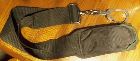

I have these rather large toolbags that I use for climbing/rigging gear. They came with a padded shoulder sling with a pouch I use for my radio, and to carry a big saw when I need it, or anything else I need to take up into the tree. I think I have four of these that I added a little hardware to, for this purpose. A couple were downstairs, so here's a pic... works well. I hate hanging a big saw on my harness. The tophandle saws I clip tight, but the bigger ones I use these, because I also hate the saw swinging around beneath me. I don't get many straight trees around here.
I can clip a saw lanyard to it, and when needed just clip to saw when I am moving around in the tree. All of my saws have been fitted with a steel ring so they can all be clipped to the Transporter on saddle, when desired.
