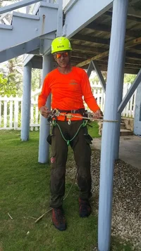

Its hard for me to tell by the pic Swing, but what is holding your snap to the side dee of your TreeMo.
Is the breakaway lanyard in fact another level of security, or is it just another potential point of failure that a climber needs to worry about. I myself would never choose to climb on a flip-line that had the high likelihood of "breaking-away" while I was working a tree. Fuck that. Instead I choose to use sound judgement, devise a solid game plan, and to do the work necessary that ensures that the trunk failure that RBJ experienced (no offense RBJ), or a barber-chair is never allowed to happen.
It's a breakaway-if-the-tree-breaks lanyard, not a breakaway-if-the-climber-weights-it lanyard. The disparity between those two forces is large if I'm using a breakaway lanyard. Just like my rope should be weaker than my metal rigging devices to avoid having a chunk of metal flying through the air. Everything in our setups should have the correct order of failure.
A keychain biner. it will hold you easily in work position but will snap if anything fails. I will quit using it now like I did before a few years back when it was suggested on hazardous trees. I never had any tree fail though. Because of precautions and inspection.
