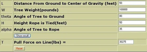

I do know via estimation that the forces are well contained within the parameters of my equipment. I also do know that the answers I got were different to yours ... hence applying your larger (worse for the display) answers to my set up in this video.
My answers were 1.1T and 1.66T on that beam. But the helpful guys above gave a hint to where theres a calculator.
http://www.forestryforum.com/members/donp/linepullclc.htm
And when I put them in I was too high also, so the forces are way lower than my calculation. I would like to see the formulae for the calculator though ... afterall can we truly say that it is infalible?

Using the calculator I entered a horror oak.
It's a 100,000lb with 10 degree lean, it's a 100' tall but we have our rope set at only 50' and the rope angle to the tree is 35 degrees coz the rope is at 45 degrees to the ground but the tree is on a 10 degree lean ... so this is a really bad example. The centre of gravity is high too at 50'. The result is attached

No math was posted only answers, and the answers from the calculator were not the same as mine or Grovers.
The request for a formula is still there and no-ones answered that. So we have 3 different answers, no formula and a bunch of failed hosedowns.
