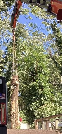

Here’s one we did in September
Lucky to be able to get lift and crane on it
The bid spec from other companies attacking it on rope and saddle are adding serious extra man hours to strip a tree like this let only rig it out, I didn’t have time to take pictures until this point it was stripped off down to wood , but look how deep we cut into it shaving it off just to work the tree. When it’s thick you have to just take your time and have extra saws to send up because even the dirt that collects in there beyond the critter nests (we have an over abundance of grey squirrels,) will slow down your saws after awhile

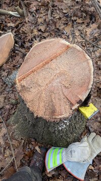

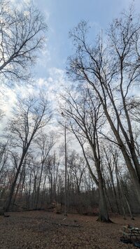

Not all from today but from this week. Some reduction pruning to help mitigate potential failure at basal defects in these Red Oaks, and a little bit of felling too. 2nd picture is with my co-worker in the front, and myself in the back stem. Very tricky climb with the recent snow we got.
