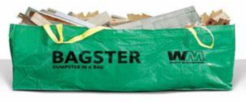

Craning brush piles is definitely easy, like coal said. I use a dead/eye sling, but you want to reserve the eye for the crane hook to reduce wear and tear of sliding rope. Because a brush pile will crush down so much while lifting and cinching, and eye can take a beating. We find it best to put the eye through a bowline cinch. Sometimes we will re-tie if the pile crushes up excessively and the sling ends up too long. Lay your longest material down first and you can get away with capturing shorter material inside. Choking to one end vs. on center each has plusses and minuses. Bagster is also dope for excessive short material.
