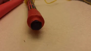

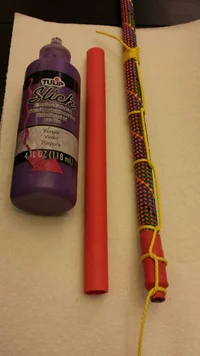

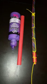

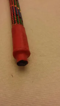

I use adhesive 3:1 shrink tube, red. Shrink it to the line leaving about a 1/4 inch overhang, then fill that overhang nub with dimensional fabric paint.
Makes for a clean end and a nice attachment for the throw line. Helps the line clear small stuff, screw links, left in place cambium savers etc.
