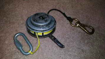

This idea comes from Nick the splicer. Use an antique pfluger fly fishing reel for in canopy throw line. The quick link is a good weight and it is compatible with the Mumford magnets.
Did I mention it is spring loaded.
