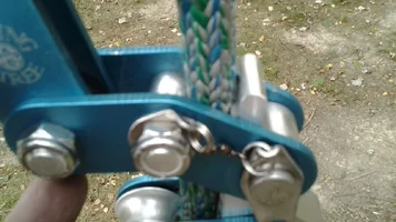

John it's dark and to dang cold out but in the morning I will headout to the truck and grab my RR. I think your design will work but I can't actually remember exactly how the double lock slic pin works. I will post some pics and try to give a detailed answer.

About a mile John, lol. I am thinking that the pin does need to go partially through the second side to get the rope through. However I think that can be addressed by a ring. Imagine your tube with a short section of tube welded 90 degrees to its side. Use your tube on the first side release. Now turn the tube 90 degrees and slide the short tube over the pin to release the pin from the second side. I don't think you will be able to control the depth of the pin very well so a pin leash may be needed so thst it can just be 100% removed and not dropped.
There might be a leash already John or maybe it's on the bottom. I have been playing with so many different inventions lately I can't keep them all straight.
What was I thinking... I have pics on my tablet for now. Leash is on the bottom but I think it could also be added to the upper.

John as soon as I got the RR in my hands this morning it became obvious that what I suggested (the ring) will not work. As designed, the RR with the double lock slic pin makes it almost impossible to remove the pin from the second side without using your fingers. The tube idea works great on the first side but there just is not enough room between the plates and the rope to get much in there to aid in the release (less than an 1/8").
