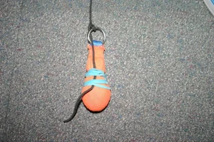

Gary,
I use a munter hitch on the throw bag ring and use a rubber band to secure the tail. The munter hitch will slip without the rubber band(s)...if the bag gets stuck, I can pull hard and slowly on the throw line and the tail gradually slides thru the rubber bands. The bag falls free and the stuck line comes back to me.
See attachment.

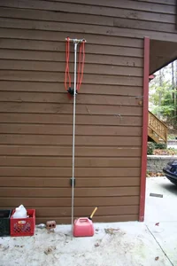

I started learning the techniques in Jepson's book first...the between legs works best for me. But, when the canopy is cluttered and yI need to be real accurate, I find a Big Shot to be a huge time saver.
I use a homemade version, 10 feet electrical conduit and a water balloon thrower. I can make 40-60 foot shots pretty accurately. You should seriously consider getting a BS to set a high TIP to protect you as you access the canopy.

Gary,
See attachment.
That is an excellent method! Scattered across various Redwood groves are several throwbags stuck in some real big trees- getting kinda expensive but it sure is a great excuse to go back and gather them at another time
I for one, think thats a great idea, thank you.
Glad y'all like the method. It has worked well for me...just don't put too quick a stop on a moving bag, use a somewhat gradual brake when slowing one down.
When manipulating it (dancing it from branch to branch to get the "just right" crotch), you need to stay aware if it has slipped any or not.
I often leave about a 6 inch tail sticking out past the rubber band as a gauge of whether it has slipped or not...if I can't see the tail I need to be more gingerly with it.

An idea that came to mind. For an elastic band, would one of those heavy duty ones that is used to bind brocoli (sp?) bundles together be beafier enough?
Yes, Mangoes, those should do fine. I have tried several kinds:
>>normal "office type" rubberbands that would fit around your wrist..I usually double and triple wrap these, sometimes even double them up (use 2 of them).
>>long, heavier duty like in the picture...maybe 6 inches long, like in the picture.
>>a section of bicycle innertube, about one inch wide.
I keep an assortment in my throw bucket to work with.

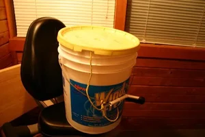

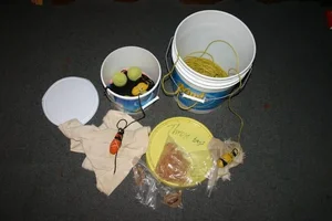

Gary, if you go the throwbag route this has helped me:
I wrap the throwbag in a cloth to keep it from getting all snarled up in the line. I nest my small backup bucket (with extra bags, rubberbands, etc. in it) on top of my main throw line...the main throwbag goes on top of that bucket.
Cut a slot for the line to go thru so the top doesn't close too tightly on the line.
