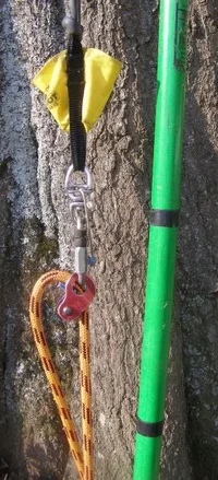

Speaking of Bigshots, I never liked'em until I saw one where Tom Dunlap rigged a trigger on it. So I bought one and tried to duplicate it from memory. I'm sure mine's different but now I like Bigshots. I can hit the crotch I want 7 out 10 times on the first try... those other 3 can still get messy though.

Hey blinky, how does the 'trigger' part of that setup work. Also, is that a pulley you have there, good idea.

This is my current trigger setup...
The end of the rope is attached to the bottom of the lower four foot section. I glued on a PVC coupling then drilled through the coupling/pole and bolted on an eyebolt.
Pulling down on the rope gives me 2:1 os it's very easy. the tape marks are for relative windage. If one shot is too short/long I hold up the trigger mechanism to the mark and adjust the trigger for the next shot.

The trigger is an archery release I bought in a hunting/fishing shop for $12. I drilled the handle to string it with the pulley.
Sherrills has a better trigger but it was too pricey for me.
It's work in progress, Tom's seemed a lot easier to use than mine so I'm sure I haven't got it figured out just yet.
