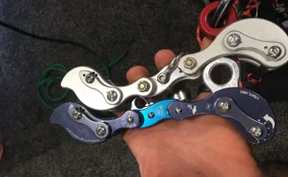

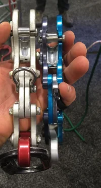

This is the Akimbo
Nice Job RE and Jamie Merritt I’m anxious to see how that tending point holds up In production arboriculture.
That’s one dapper looking AKIMBO!

interesting.. Seems a little clunky in thought to clip into it, pull down the small gate hook then release. I'm sure one would get use to it.
I haven't seen the rock exotica version in person, but from the image it looks like you could use a small ring for tending and just push down on the corner of the spring on the clip with the ring. Similar to how you open a Caritool with a ring on the saw lanyard. Seems like it'd be an easy one handed attachment.
It looks like it would work well. My concern would be that I like to keep my tending point attached and sit back or pull back while standing on the rope because it keeps me in a more upright position and this tending clip looks like it would auto release.
It looks like it will hook to a chesty with a ring with one hand and release with no hands, just a downward pull as Jaime said.
I just love all the new refinements. A lot of thought has gone into this tool and it shows.
Or a small biner or dog snap, snap in then sit to release. Guess I will try it out when the new shiney arrives.
We tried to orient the gate so that you can lean back without disengagement but how well that works is going to vary a lot based on where your chest clip is located and how long your bridge is etc.
