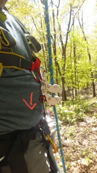

Lesson learned update: NOT TOO TIGHT! So after a lot more climbing and experimenting, I was still having trouble with high drag during accent (not the @JeffGu kind of drag :^), the Akimbo "jaw" was also not opening very wide when I loaded it. I finally had to step back and look at the bigger picture. Up to this point I had been trying to minimize the gear chain in front of me and keep everything between my chest harness and saddle as short as possible to keep myself upright during accent. Then I realized that by doing this I was actually tensioning the bottom of the Akimbo as I climbed (see force arrow below)
Once I realized that, I loosened my rope bridge a little, and added an extra keychain biner to tend the Akimbo like this -
Still very minimal, but that released the tension, it let the jaw swing open when I load it, and now it slips up the rope with less drag than my foot ascender.

I believe when tending a mechanical we need to pay more attention to supporting the weight below the attachment point of the device. If added up the ring/plates used to attach the bridge, the ring and/or swivel on the bridge, the weight of the webbing attaching the leg loops and the leg loops have enough weight to engage the arms of the device creating unwanted drag.

Or just connect the point below (in my case the top of my swivel) with either of the awesome devices we have now! Anytime I have connected my tending harness to the device directly it sucks. But connect to that swivel, ring or plate below and presto smooth as butter.

Hmmm, skip the tending shackle altogether.... brilliant, I need the rain to stop so I can test that out.
My current setup is - rope bridge > aluminum ring > locking biner > Akimbo
I might test a small parachord loop through the lower connection point on the Akimbo, or the carabiner below. You would have to attach in a way that will not disrupt the Akimbo's position on the carabiner, I wouldn't want it to get askew and sideload anything.
FF no need for extra para cord clip right into the ring (above the akimbo when slack) works like a charm... works with the RR too! I'll try to get a picture today.
Shucks didn't think I was gonna have the extra time this morning. Here's the picture.
This does look like a viable option and would make drag a non issue, I am definitely going to give it a try. It also looks like it might add a little more slop than how I have mine setup, this would only matter any time you stop ascending, either at the top, or part way up if your an old fat guy like me.;)
With the slack out of my system I can literally sit in place with only 4 or so inches of drop and no manual tending, more than that and I'm sitting on my knee ascended in a crouch. I will play around with this though.

Maybe with an adjustable bridge that you shorten all the way, you could attach the slacktender to the top of the carabiner or directly to the red attachment point of the Akimbo, via a small accessory cord loop, or soft shackle?
