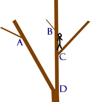

I also have a quick question for you guys. Below is an image of the predicament that I found myself in. My anchor was at point B and I wanted to get to point A.
Even if I brought my throwline into the tree with me and tossed it into the crotch at point A I would not be able to retrieve the thrown side unless I used a small grapple hook to swing it over and retrieve it. I assume you guys RARELY use the grapple hook technique, is that correct?
What I ended up doing was rappelling to point D and then girth hitched a sling (since I don't have a lanyard) and moved it up as I climbed my way up the left branch. I ended up with an almost horizontal main climbing line so I brought up the tail end of my climbing line and built a second anchor at point A. I could then lower myself to which ever side I needed but I still had to climb back up. Is there an easier way of doing this?

There are several possible solutions depending on the situation. If you're trying to set up a traverse with no ground support then you probably did the simplest thing possible - climb down/climb back up.
There is a way to throw a ball so it comes back to you.
A long pole hook or RE-Treever works good.
Ever heard of a Jam-Knot (use extreme caution!)? (only use if the potential swing back is not life threatening)
Set two lines before leaving the ground that way when you want to climb up that other lead you have a rope to climb instead of girthing slings.
Ground helper can pull you over.

In addition to what Raven suggested for getting over to "A", you could get a NT Yella Grapnel to get your throwline back.
You could ask check out yoyoman's magthrowbag setup.
I'd go for a grapple hook straight to point a if possible,then use a friction hitch or ascender to capture your progress as you pull across.

I haven't heard of a jam-knot but I assume it is similar to building a stopper knot in rock climbing and smashing it into a crack. This is a great idea! I added it to my arsenal of ideas.
I kindof made a DIY Grapnel hook for this purpose but I don't use it much because I always get it stuck on twigs and stuff and it gets really messy! I will have to check out yoyoman's setup, I am sure he will be chiming in soon.
Ah yes! I forgot about using a grapple hook as the anchor point vs just using it to retrieve the throwline. I like this idea a lot I just need a more durable grapple hook.

My favorite way to traverse is simply climb higher and swing over (or set my line higher from the git go). If your anchor point is close to the top of the tree for most trees you should be able to access everything with only a few redirects.

You could use a Throw-hook (no idea if thats correct in English?!) on the end of your line and toss it to point A.
But then I'd really suggest to climb higher first so point B is above A. That makes pulling over a lot easier and safer (beware of the forces on the anchors!).
But when point B is higher you might just swing over like someone wrote before, probably the best solution at all...
