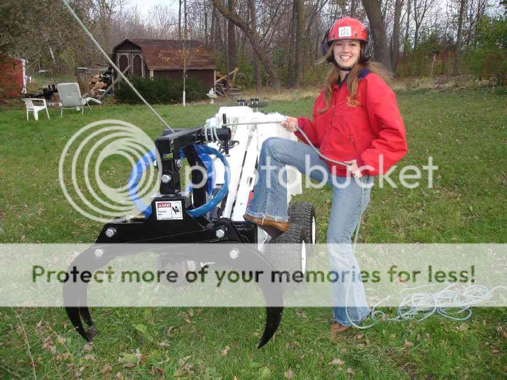

Yea Dave would know best, what runs his grapple best. I could of swore he used to use Ramrods all the time. I'm sure the pic of the cutie with her leg hoched up on the grapple is connected to a white wheeled ramrod.
I have been blessed to have mini Grapples on 3 continents and on ALL the mini models out there that I am aware of.
Talking to these varied Mini Owners across the country 99% (Jamin?) love there machines. They tell me they would not go back to operating there Tree Biz with out one, and to a man they lamented not buying a mini sooner.
Now my company had a big Clam truck so all we needed the minis to do, was forward the the tree to the street. Loading logs was not an issue for us, we fed the chipper brush and staged the logs at the curb.
So thats why I have not been so concerned about the specs on all the different models, 8" more lift than another, 200 (supected #s) of more lift, Big whoop to me. Its all minor to the HUGE advantage just having any machine will do your tree forwarding and handling operations.

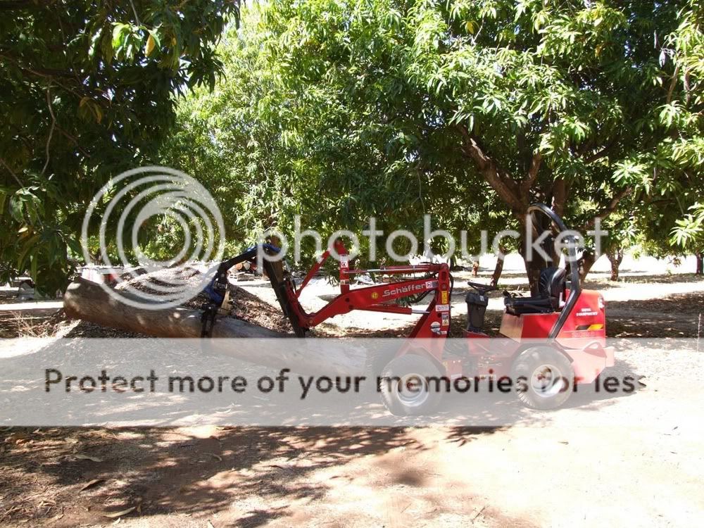

Here is a BMG in Austrailia on a German made Schaffer articulating machine.

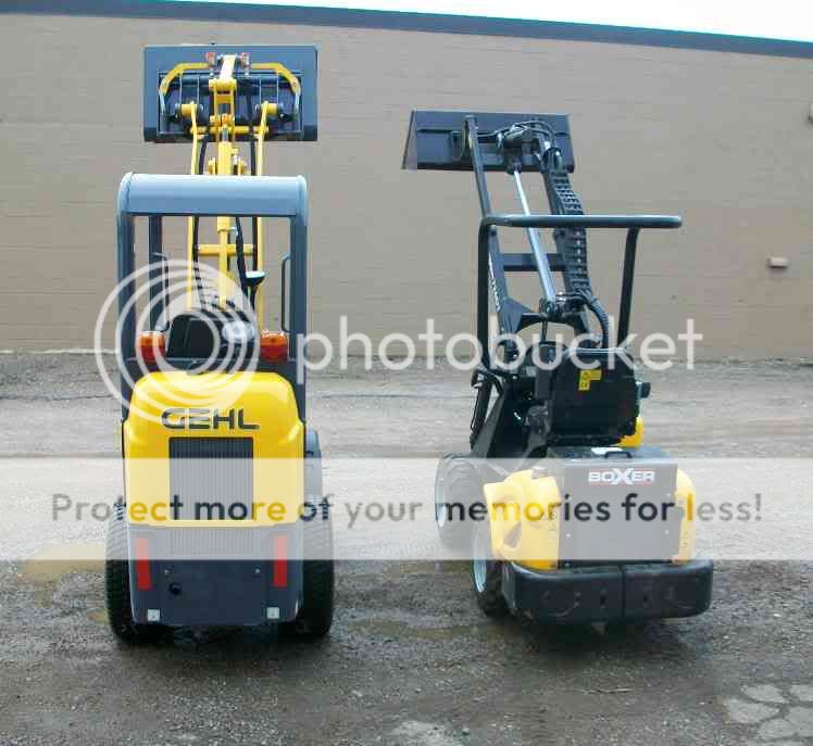

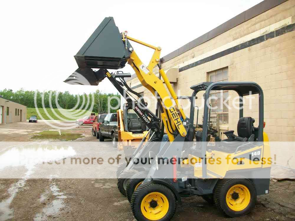

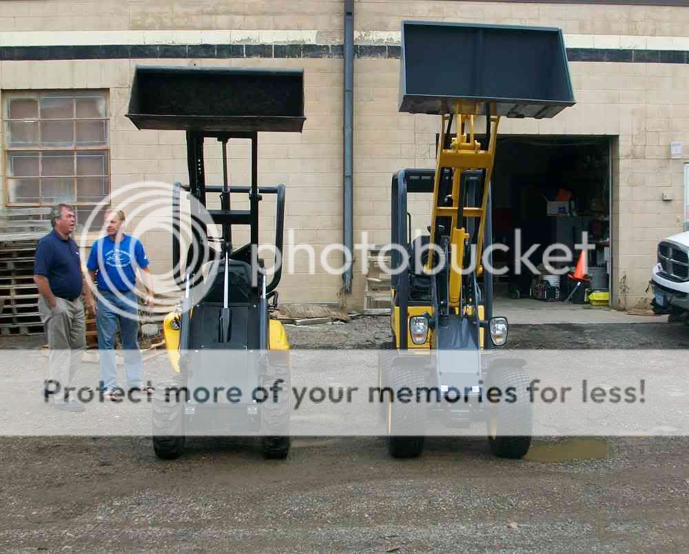

Here is the Gehl140 next to the Boxer 726
Got to tell you the Gehl is thrice the Boxer
Better price than the Boxer, Swinger and Wacker, American made, Excellent Parts and service reputation. No brainer decision which one I would buy
