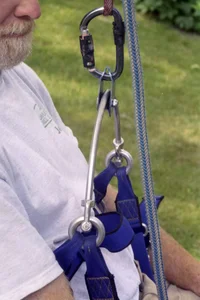

In 2000 I got an idea for a solid bridge. After a couple of coat hanger mockups I bent and threaded some stainless steel rod. A swivel clevis was used for the ends.
The CMI pulley worked just fine, is compact but it might wear too quickly. The sailing one is bigger but wouldn't wear out.
The bridge made a HUGE difference! Even though the Treeflex has little hip constriction the solid bridge eliminated it.
Super comfy!
After a few weeks of climbing the bridge got a kink in it as you can see. I talked with a friend who is a machinist who suggested a different stainless alloy that was more springy. He did some number crunching and told me that the bridge I built would likely have a breaking strength somewhere around 9k#. Plenty since the rest of the Treeflex isn't built that strong...doesn't need to to pass specs.
