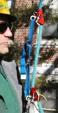

Many years ago I made this setup. The upper is a microcender, the lower is the where I put the Rocker instead of the Micro that's in the pic.
In use, I'd grab the rope and push the micro up just the same way that an ascending loop would be used. The Rocker would be dragged along as a passive, second attachment point. Not really a backup, more of a redundancy.
Look at the second pic for a better idea of the lower configuration

The Rocker is on the other side.
The Stubby thing is to keep the Rocker located up top and not let it slide down the other leg of the biner. Think of it as a slack tender for the Rocker.
