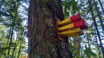

In case anyone wonders wedges can lift a F-ton, when used by a skilled practitioner. Wedges and ax are considered ppe for fallers, by some.
I'll try to set up a triple hinge stack, if I can...I have to high stump a tree from a springboard, so it is not an ideal set up for the triple-wedge, and it's a tree that could use a double-stack, if that, as it's not back-leaning.
Stacking the three wedges gives amazing lift for back-leaners.
This is our favorite stacking method. Works great and much less of an opportunity for wedges to kick ou under the tension. A lot of times I’ll add one on either side of the as well just as helpers/stabilizers. (Which I did on this stump, just couldn’t see it in the thumbnail). I personally like to stack into the stump but I’ve seen guys stack into the tree, personal preference I think.

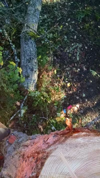

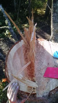

Homeowners put in new electrical service to the cabin a year or two ago, but didn't take down a lot of dead trees, however it was a root-pulled, live willow that took the line down, and tipped the mid-span pole with meter. Pulled tight against the power mast on the house, but didn't damage the house. Roots took a bit to rip out, using the 12' lever of the trunk, so it might have been a slow-speed root failure.
IMG_20181204_130737525_HDR.webpIMG_20181204_112637656.webpIMG_20181204_154100325.webpIMG_20181204_112658220.webp
I did get good fiber pull from an overly thick hinge and hard pull on this other one. Tapered was not intended, particularly, as much as being sure I didn't lose the dead tree to the power line, and I was in an awkward cutting position, as I cut my seat too wide, and ended up with a down-sloping board. They are so useful, just don't cut your seats too much.
As you can see, I did have to clean up that far side, as I missed my Humboldt by a kerf-width.
Best time, I'll mark my board's seat before cutting.
This being dead, and relatively small diameter, I didn't want to cut deeper for a tighter seat.
18" at the hinge.

I haven’t had a good opportunity to stack like that. You know the experimental tree in a feild where if it goes wrong there are no targets. Is the standard a few stacked bore cuts just bigger than the wedges? How hard is it to retrieve the wedges after?
Any pointers?
Also where do you get the spring board tips?
Use a side wedge as back up.
It works.
Less likely than stacked wedges to spit out.
Single taper, not double taper wedge, ime.
Good leading edges. Tap all three, set all three, drive all three.
The springboard shoe was a present, with a hardware store 2x6 that is okay enough.
I was wondering about getting a batch made, and selling, but I'm Overloaded, as is.
I can email you good pics. Simple fabrication.
I was going to ask @rico to start a spring board thread, presuming he has more and different experience than I do, and at least, somehow I think the local knowledge there has infiltrated into him, osmotically.
When your wedges are still sunk in the bore cuts, back chain of the mushrooming.
Just wide enough for the wedge, and a little more, will keep them from twisting. You have a chainsaw. Getting wedges out is not a problem.
Launching your wedges with the tree is a good way to weaken or break them. Always easy to retrieve from the stump.
