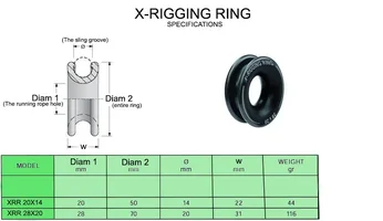

- Regarding my 28 X 20 ring, we measured the diameter and it was 28mm, what part of the ring does the 20 describe?
"CHOP CHOP", is this Southpark? yes, my humor is Southpark like.
Here are the dimensions to help answer the size questions.
