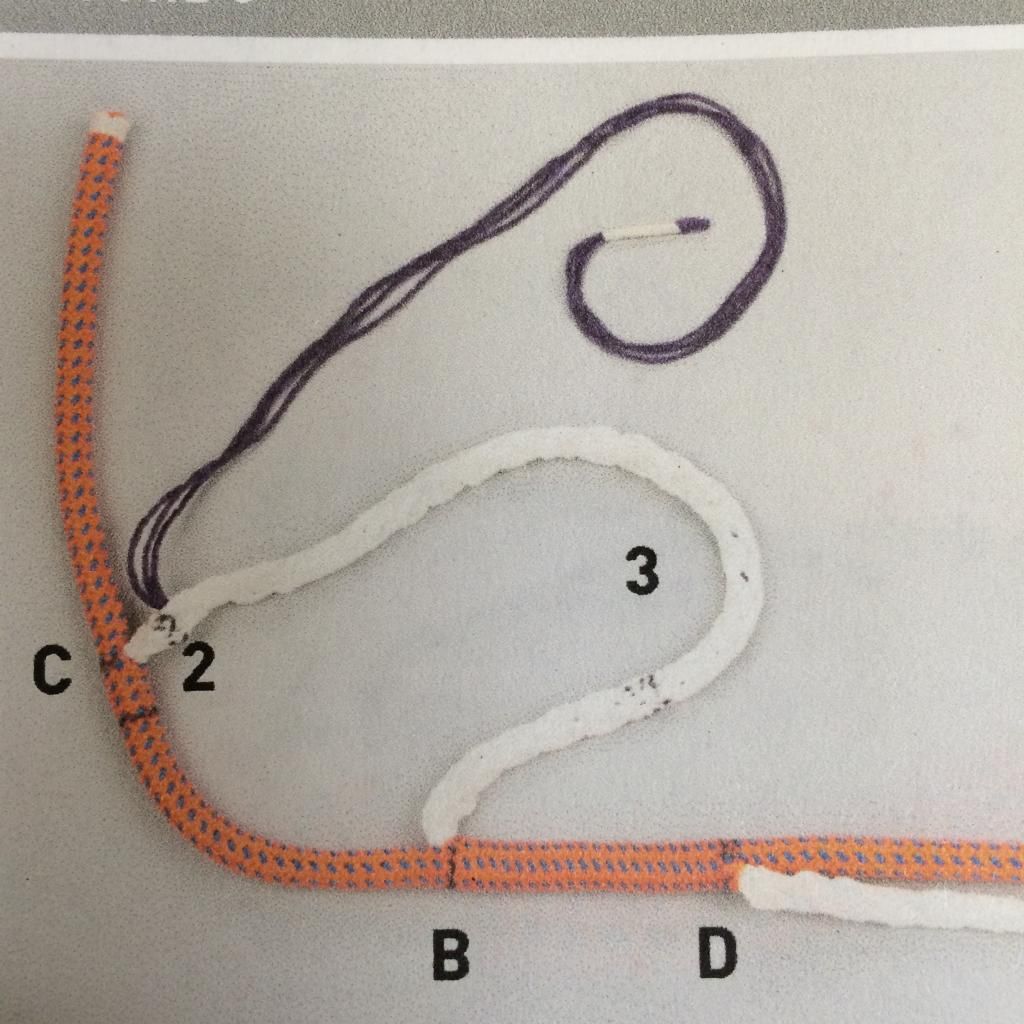

I cut some of the rope to expose the core. (The first time I've seen tachyon core) I see the three inner core strands (purple). But with the outer core (braids of 4 strands is what I'm seeing), is there anything special to do with that during the splice to make the final bury easier?
please tell me where to cut the inner core those of u who remove it! Im gonna try with the inner core left in and see how it goes.

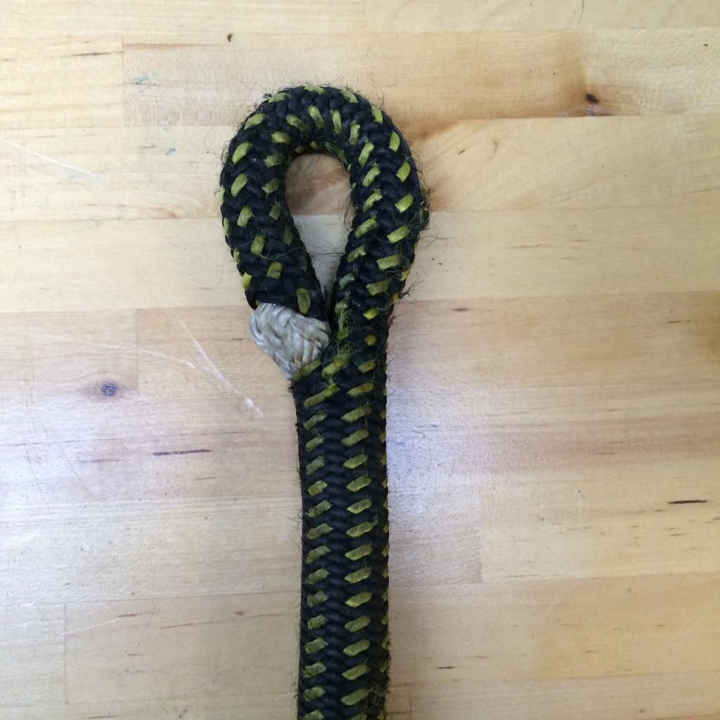

That's all she'll go. Not really sure what I did wrong:(
looks like the only thing you did wrong was trying to splice used tachyon... You can try pulling it out and lubing it. Burying with a MA, and some whacks with a hammer handle mallet or the like. I do think your dreaming though. I did once splice a hank a little newer than what yours looks like, and swore that I would never attempt it again (it took nearly half a day).
Well, all i can say is ML got me drunk and i m never doing that again... Note to self, don't do that. It felt like i was doing something wrong the whole time. I used a come-a-long between two cars after i ripped my anchor point out of my basement wall (my new splicing bench lasted 3/4's of a splice, haha.

I cannot figure out this step. The core does not want to bury all the way to D. The 3 times I tried today, I got about an inch and a half away from D. The directions do not say how to taper the carefree this step. Any ideas on what the best way it to taper? Somehow i got it with used rope but can't with new rope? I want to get it this way but I'm about to remove the 3 strands and try the Samson instructions.
Is it possible that you picked a strand with your fid? That will stop a splice dead in it's tracks. This is where I would check first, look all over and see if you can find any distortion on the cover.

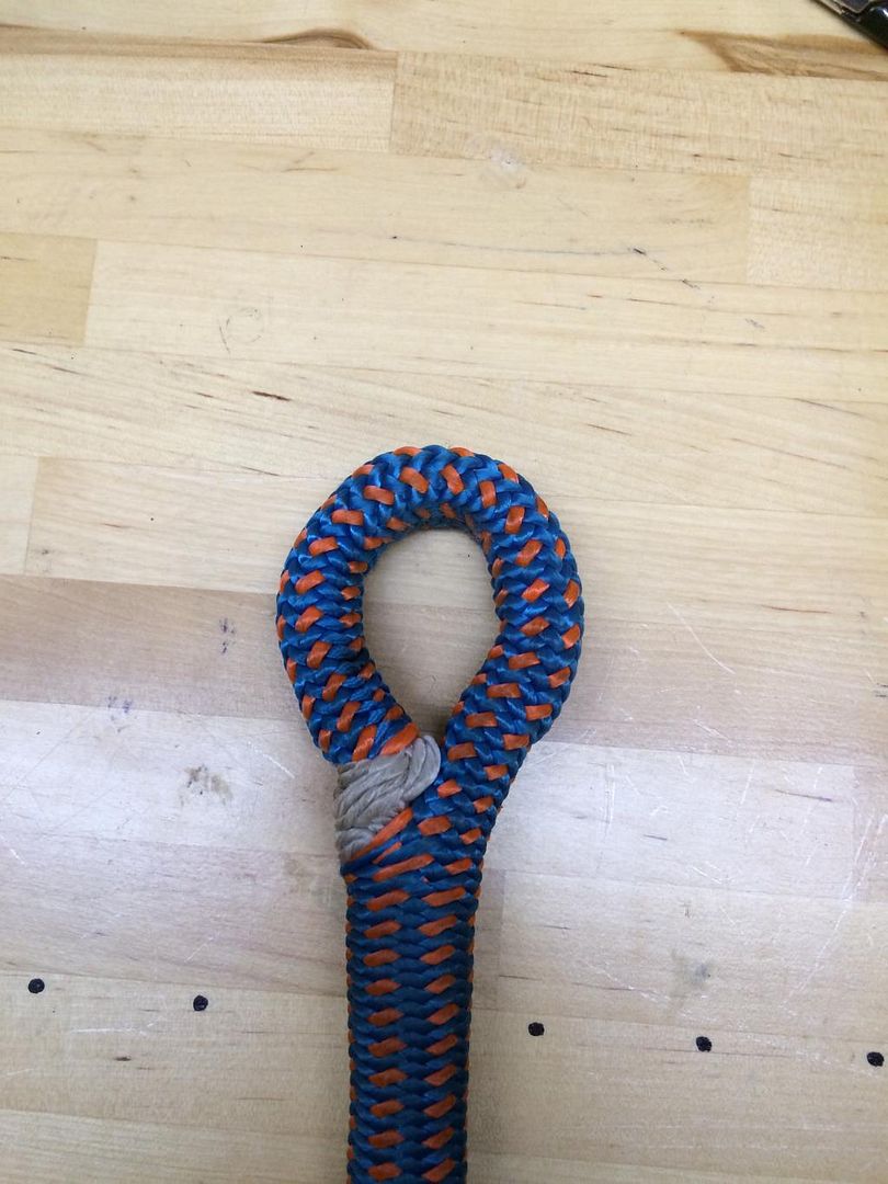

It was snagged on a core strand. Good call! Did one more attempt. I got this far by massaging/malloting/pulling. So hopefully the come-a-long will be able to finish it tomorrow. ML, how much does ur EZ-pull pull?
For the overlap bury, I tapered about a foot of the core a good bit and it went through like a dream. If it doesn't go through easy, take it out an taper more!
