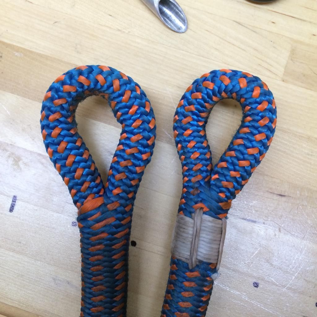

For the overlap bury, I tapered about a foot of the core a good bit and it went through like a dream. If it doesn't go through easy, take it out an taper more!
I would love to add to this, but I would get told off...so i'll put it in the form of a question...
If the core was tapered more, the full length(of the splice), lets say by 1/3 and that would be part of the eye, would that effect the strength by much? plus the eye would be softer...wouldn't it?
I used a rubber mallet and whack on the bunching right there to help work it in. It can be done.

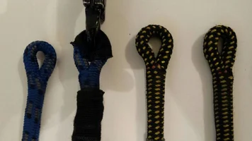

I managed. I measured these for a bit looser eye.
I have a few splices I cannot use the larger biners for. It's frustrating when that happens. Splices look good, nice job!
