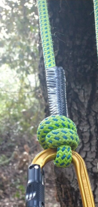

Everything looking new and shiny and clusterfuckish. Clean that up. Hell no. No. what in heaven's is that tachyon termination, tape homemade kiddie stitch madness. you see others using that rubbish too. Do not follow the multitudes of clowns on youtube. Dangerous practice. Climb safe please.
It's a piece of tape to keep the termination tail out of the way. Yes I have a fair bit of gear that is newer in this pic. I've been an Arborist for over a decade but transitioned to consulting and treatments after a few years of climbing. I've been having fun rec climbing lately, venturing away from my Blake's hitch days although I definitely still use it. Playing with different systems and configurations brings me joy, i never felt I had the time when it was my job. I'm just giving an example of configurations to allow some open discussion. I embrace well thought out criticism but wish we could be nicer to each other. This is a passion of mine and like feeling proud of our community. Thank you everyone for your input

I believe that is a scaffold knot, and the tail was wrapped with electrical tape for some unknown reason. I don’t think it’s a sewn eye.
OP said to keep termination tail out off the way.
@Winchman I consider a scaffold knot to be an absolutely essential knot to know! Maybe because it’s the first thing I was shown.
Man oh man, that little bit of electrical tape on that tail has really got a lot of panties in a twist.......
I call it a double fisherman's loop but it's more technically a scaffold knot.

Seriously lol, thanks I'm kind of over addressing it at this point.
Fuck de electrical tape....but man I hate knots on any terminations in my climb lines or lanyards.....and I truly hate tachyon bungee cord....but brohammer up in SoCal seems to dig it all.... bless him. But I only climb SRT so nearly all my lines have no splices. Crane work ones do..... Horses for coarses though... Power to SoSal man...
To each their own right? It's a 12 foot lanyard so stretch isn't a big factor. Just a pice of rope I had around and figured I'd get some use out of it, an eye would be preferable though.. I enjoy moving and stationary systems, they both have their place and I like to go back and forth. Mostly srt these days though. Thank you for your blessings.
