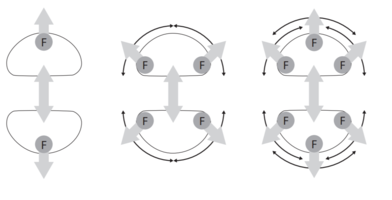

This is all just theoretical for me but mostly just simplicity. I still kinda like the idea of being able to clip a secondary system to the bottom of the swivel. Seems like it wouldn't side load like an MRS system clipped back to it and the ring is already there, why not use it. Idk I'll probably just go back to my rook, just playing with different systems. Here's the axis chart from DMM, I can see how it might not be in line with it but kinda suggests multiple anchor points would be ok.Screenshot_20221222-142636-572.png

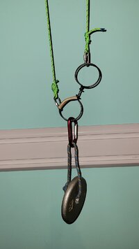

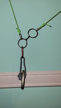

As Dan Cobb was saying, it looks like the scenario of clipping the end of MRS system to the bottom of the swivel would cause a bit of side loading. Probably ok under my weight but not worth it for a primary system. This is an example of the secondary scenario I was considering where I just clip my lanyard or tail as a secondary system for work positioning. This one seems pretty ok for me, doesn't seem to side load and the swivel is still able to swivel for one system. Open to thoughts and discussion ✌️

I don't understand why this would be more simple than just clipping directly to your bridge.
More simple than keeping another ring on the bridge as you said. The bottom of the swivel already kind of acts as a ring/master point and less to shift and clank around. Biner straight on would be simpler I guess but less desirable to me. Doesn't matter, I think I've gathered the information I was looking for. 1st scenario was pretty crappy, second seems super legit. Pros and cons to everything.

First pic is just hitchclimber in MRS configuration that's clipped to bottom of swivel instead of back to hc pulley. Was exploring that as a potential option if a termination knot hits the hitch or for cleanly running a mechanical like an akimbo in an MRS configuration without something like rook or gyro.

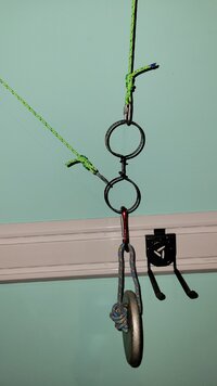

For the lanyard, that's just some tape to keep the dangle out of the way (not stitched). I don't untie it until I need a new lanyard.
