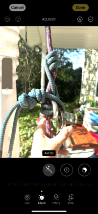

I cannot believe this discussion is still as ongoing as it is. The problem with the sticht is the endless variables and that’s why people hate on it. A pinto spacer below helps tending but will get disoriented eventually. Simple is best. I don’t climb much anymore and went back to other stuff for work, but I work climbed on this for at least 6 months straight. Supreme tending and adjustability. Descents aren’t quick but I was never one for a quick descent anyway. Tighten the double overhand for more grab, loosen for less. The sticht is supreme for lanyards and hook lines. With less additions, you can hand tend in all directions. Pictured ring is too small if you want to tend with a chest harness, I think it was the CT medium blue ring was the best. Effortless tending with quick grab.

the big ring on the figure 8 is captured below the wraps on a distel hitch. not midline attachable. tends smoothly. (the snap biner is for demonstration only). @Brocky probably knows the correct hitch to use instead of the distel.
